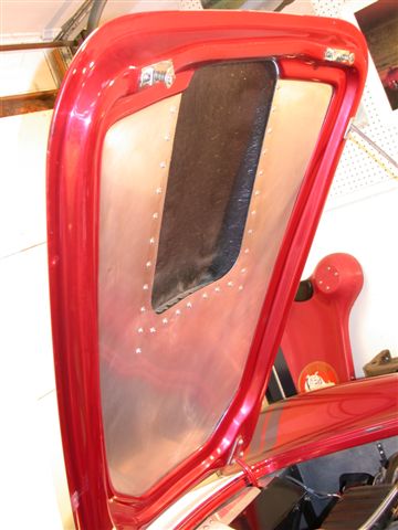

Chuck,
Ron Randall finished the underside of the hood on my ERA. Below is a picture.

Thanks Rick for the great picture. It looks great.
Chuck

Hi Chuck, the aluminum process we do at Metal-Morphous, Inc. is real aluminum, I can plate just about any surface with 8-10 mils of real metals like aluminum, brass, bronze, nickel-silver copper and stainless steel. We plated Ricks's hood AFTER it was painted and if you look close you can see its seamless, the scoop is just polished out. It can be polished, steelwooled and polished back out again. We can create some great effects with differant finishing techniques. If you would like more info just give me a call at my shop. the # is 203 294-1314
Rick, thanks posting some great pictures of my work, your cobra looks awesome
Ron Randall
