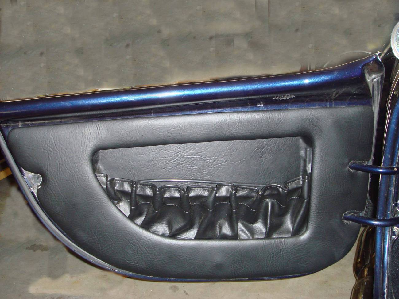

Old 06-19-2009, 08:28 AM
Join Date: May 2009
Location: Fremont, CA
Cobra Make, Engine: Everette Morrison HP 396
Posts: 29
Default EM door panel removal...and photo
Finally here is a photo of the door panel....thanks for suggesting how to upload it..
Does anybody have any suggestions or knowledge on how to get the panel off the door?
Thanks all for your continuing assistance....
Ciao
Old 06-19-2009, 08:57 AM
Join Date: May 2006
Location: Manteca, Ca.
Posts: 2,439
Are there any screws on the inside of the door pocket?
Not the same brand by mine has plastic snap in clips to hold the door panel to the door.
Terry
Old 06-19-2009, 09:36 AM
fastraxsg's Avatar
Evryday is a roadstr day
Join Date: Jan 2004
Location: North Jakarta, Indonesia, Oh
Cobra Make, Engine: RHD Hurricane street roadster HM1081 aging nicely in the garage
Posts: 5,725
I would guess from this bump on the bottom of your panel, there is a tab there that presses in to hold the door on. Can you get a small screw driver under the panel at that point and have a look see without ripping off the material? If not, you may just have to take it to an upholstery shop and get some help the first time.

Old 06-19-2009, 10:01 AM
Location: Post Falls, ID
Cobra Make, Engine: Everett-Morrison
Posts: 111
Default Filippo
1. First of all, to match your blue paint, I'd go to a good body shop and let them try to match the color the best they can.
2. Your suspension sounds like Corvette, if it's all aluminum.
3. I'm willing to bet the door panels are velcro attached, or, possibly, they might be attached using a wire clip of some sort that goes into the door itself, and not visible from outside.
I would take a 2" putty knife and slide it in between the door and panel, and move it around the perimeter of the door. You'll either hit the velcro, or feel the wire clip. In either case, pry up with the putty knife or small pry bar to remove the panel.
Also, which end of the cable came off, near the hinge or door latch?? If the cable is still attached near the door latch, , you should still be able to open the door by simply pulling the cable towards the hinges and that will release the latch.
Hope that does the trick.

Old 06-19-2009, 07:59 PM
Join Date: May 2009
Posts: 29
Default Response to ZOERA-SC7XX question - how does the door panel come off...
There are plastic pins attached to the back of the panel that are pressed into holes in the door...a body shop will have the proper tool to pop the pins loose and remove the panel....
Regards....Filippo
Old 06-24-2009, 08:07 AM
tbracker's Avatar
Join Date: May 2007
Location: Brooksville, FL
Cobra Make, Engine: Everett-Morrison Gen IV, 427FE
Posts: 32
Send a message via AIM to tbracker Send a message via MSN to tbracker Send a message via Yahoo to tbracker
I'll tell you this much. You do not have a Gen IV model. Since that is what they are making now, your chances of getting parts for your older model EM are not good. On the other hand parts like door latches are widely available from other sources.
As for the door panel, just pull it off. It may have velcro or glue or snaps, but it should pull off.
