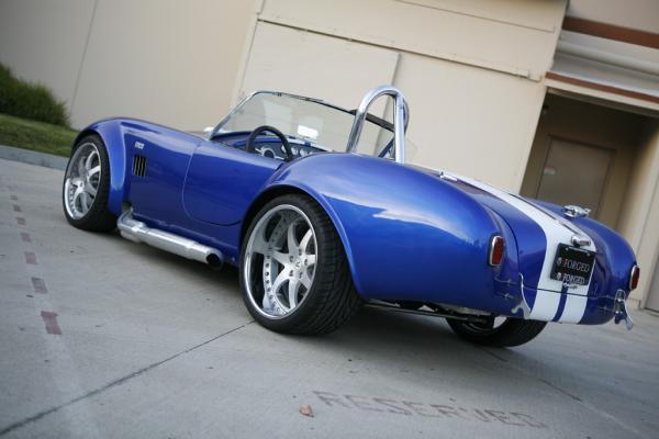

Here you go. This is a FFR with pin drive width control arms and deep dish wheels.
Bruce

Thanks for the feedback and photo gents.
My buddy currently has 275s up front on T3 17" wheels that stick out a little. He does currently have the standard (non pin-drive arms) control arms, and looking at pulling them inward now (using inner mount points) to see if he can get 3/4" more narrowed out of it. He really wants to figure out how to make 275s up front and 335s in the rear fit, and tuck in a bit under the fender lips, while keeping the longer control arms for handling/geometry purposes. Aint gonna be easy without further customization, or as it seems.
