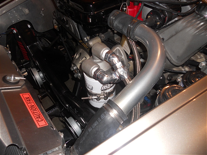

Comp cars used a bracket on the front of the left head with a cast housing remote filter. Parts for it are readily available from me, Finishline etc.

I have a dual remote filter mount on the front crossmember, plumbed before the oil cooler. I also ported the mount to clean up the passages for better flow. Always put your filter before the cooler as hotter oil flows through the filter easier.

It's not going to leak, it makes changing the oil slightly easier, and it looks cool. Just safety wire the filter like you, hopefully, safety wire everything else.
