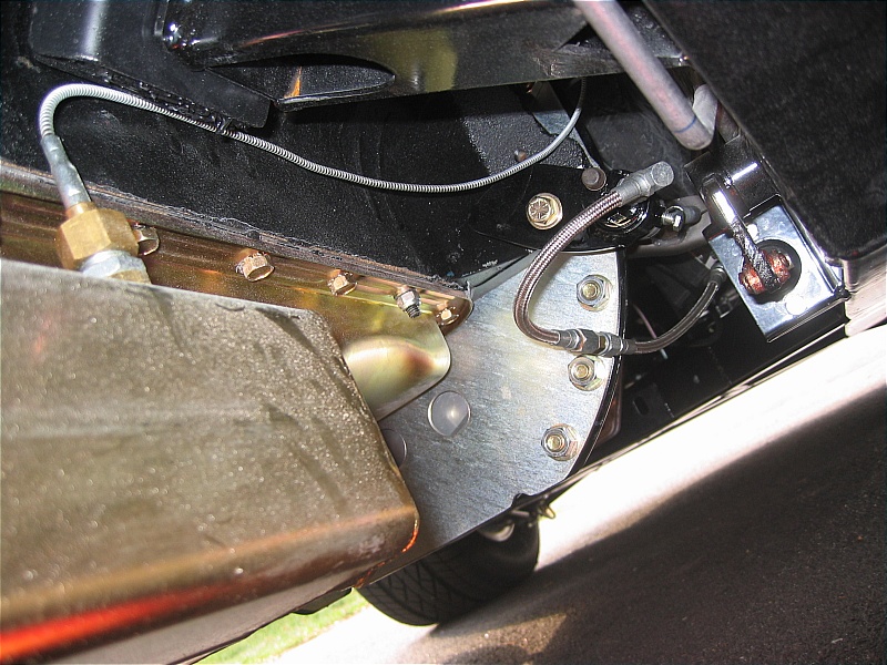

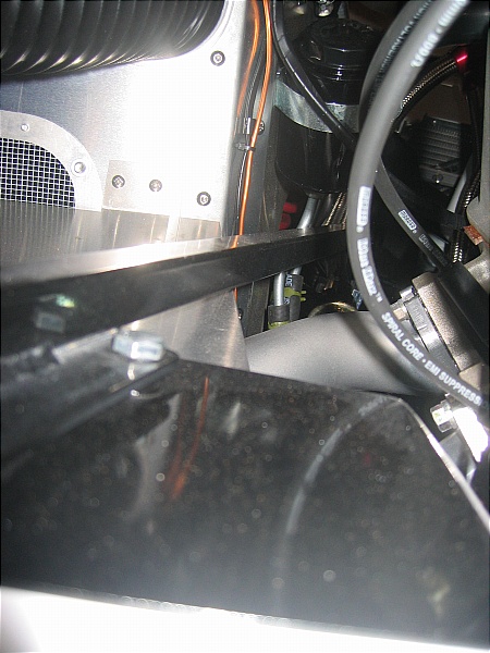

The oil temperature sender is located on the driver side rear of the Canton pan. The sending tube goes straight up and through a grommet located below the fuse boxes, There are two grommets there, actually, and the passenger side grommet is for the speedo cable and the driver side grommet is for the oil temperature sender. You can't see it in the second pic, but the arrow is pointing to it. The oil pressure tube runs from the filter housing directly over to the fender and up and under the fender to a hidden grommet along the firewall. You can see it in the pic and the other red arrow is pointing to it.

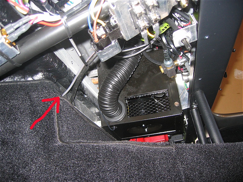

Oil temperature tube as viewed from inside the car.

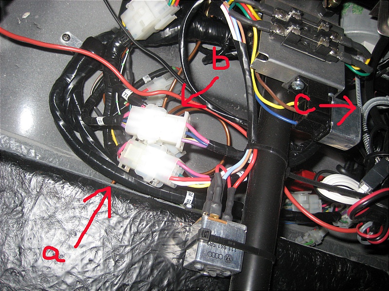

Note that the oil pressure line is insulated from the filter mount over to the fender wall. From there it tracks up and then straight towards the hidden grommet.

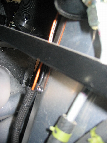

This is a good shot because it illustrates three points: A is the entry point of the oil pressure line, through the hidden grommet on the firewall, as viewed from inside the car looking up. B shows the oil pressure line loops that help to avoid vibration leaks, and C shows the loops for the excess capillary tube. Someone around here, maybe it was Chas, tried cutting and splicing the capillary tube instead of looping it. (No, it wasn't Chas )

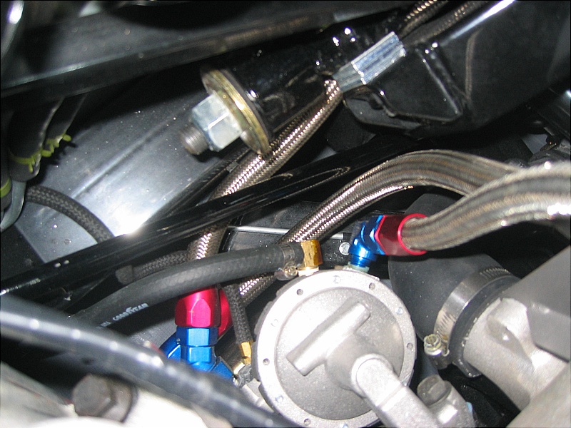

Ahh - more pictures. Should be self explanatory now.
