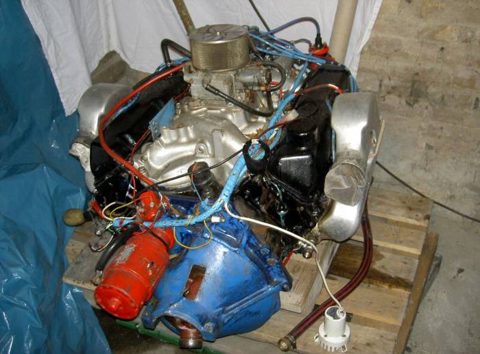

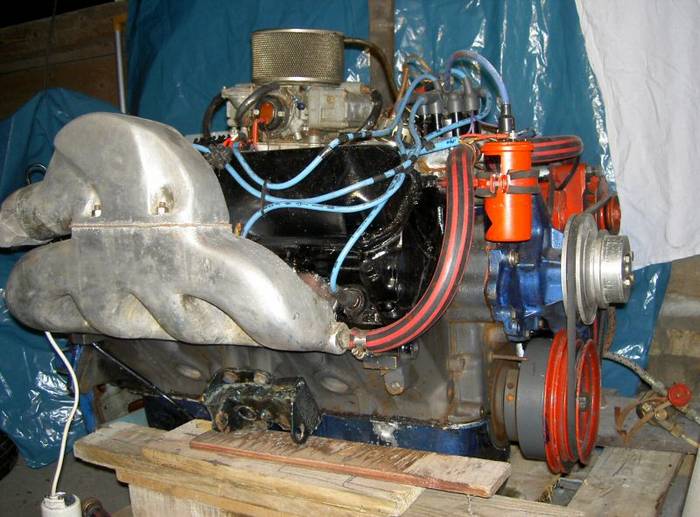

These are pictures of the engine:
As far as you can see the valve cover mounting surfaces look different from what you told me and the heads are also different from the FE heads pictured above (spark plug locations).
So this seems to be a 385 series big block, or am I wrong?

Your right -> a 385 series big block
