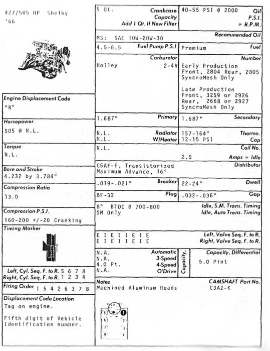

Originally Posted by RICK LAKE View Post
The info you have for oil pressure doesn't include the Nascar motor. IMO if you want to run a heavy bottom end motor on 10-15 psi of oil thats your choise.
The closest I can get in my old manuals to the Nascar engine is the R Code Specs below, 505HP, 13 to 1 Compression. Here it is (but I will concede that there is always the possibility that someone puts the wrong parts in). Note the oil pressure specs in the upper right hand corner.
