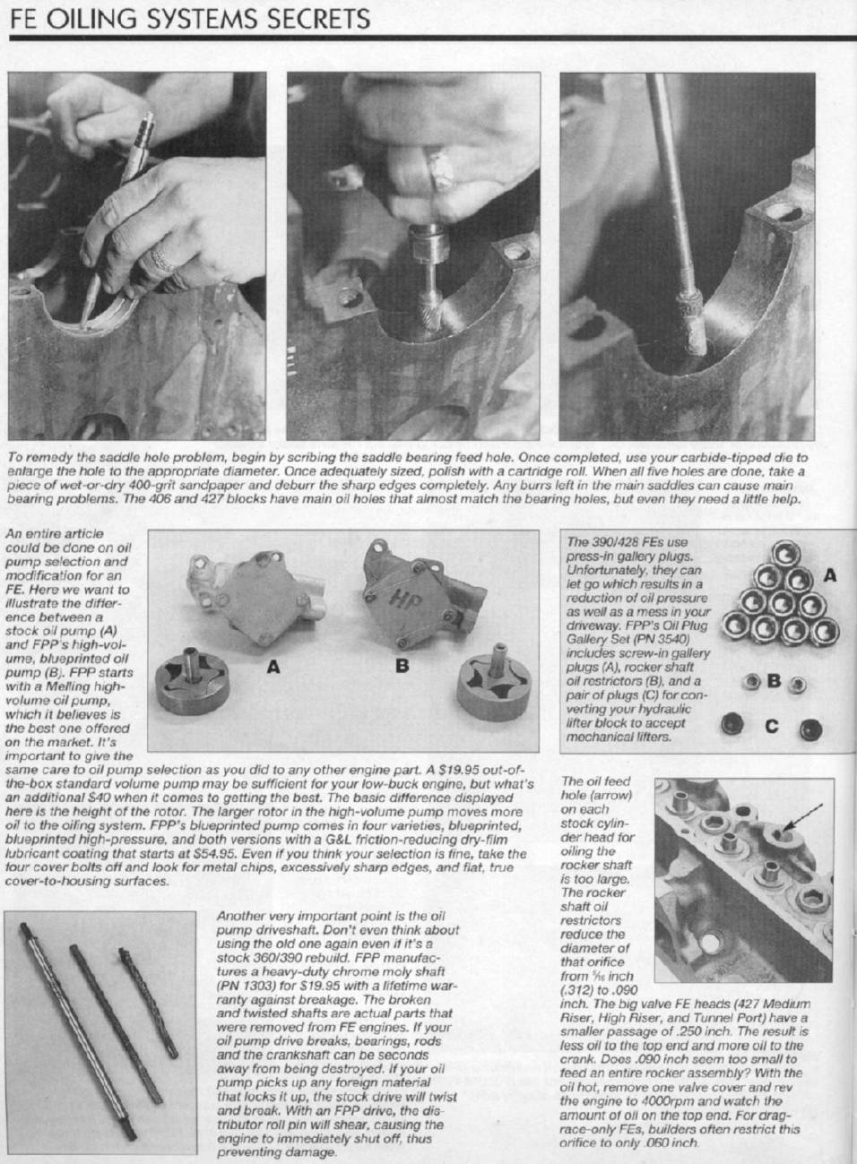

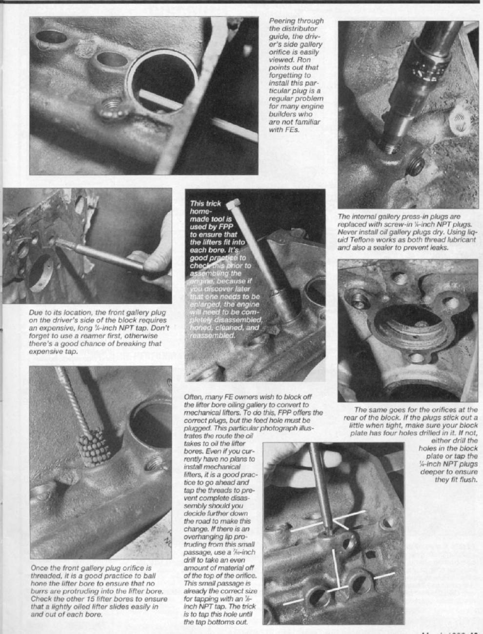

For those of you who are really interested...

Good read!
Thanks

I used the same article in the build last year of my 1967 428 FE , then I put in a 5700 chip in the MSD to play it safe . It works great and had no problems . But I would be verrrrrry afrrrrraid to turn 7000 rpm,s .
