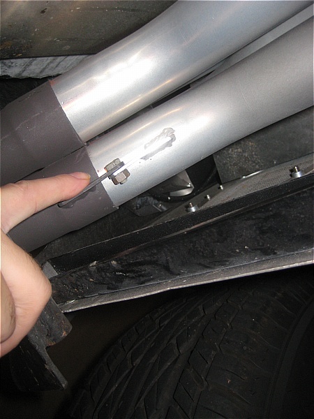

Matt - here's one thing to watch out for when you get your headers ceramic coated. You don't want to ruin the slip fit where the primary pipes slip in to the sidepipes. Here, I took a picture of what I'm talking about.
