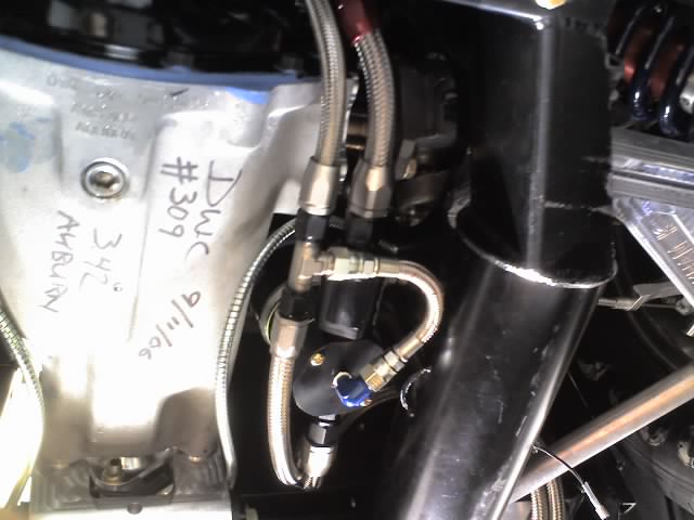

Default I used the Malory pump supplied by Mass Flo.
[IMG][/IMG]
