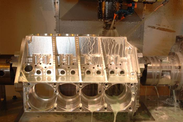

Drilling the oil galley.

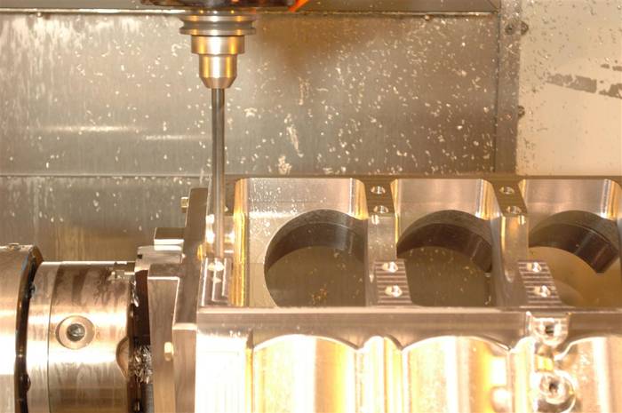

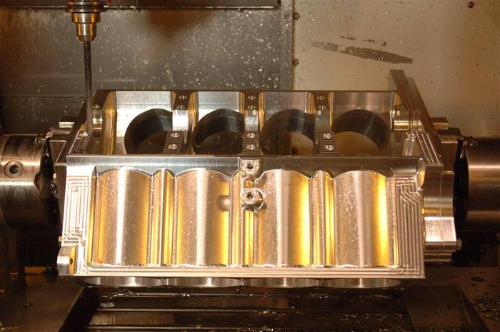

Milling the outside port for the main oil galley. We eliminated the lower oil remote and will plumb the oil cooler hoses directly to the block...why have extra parts?

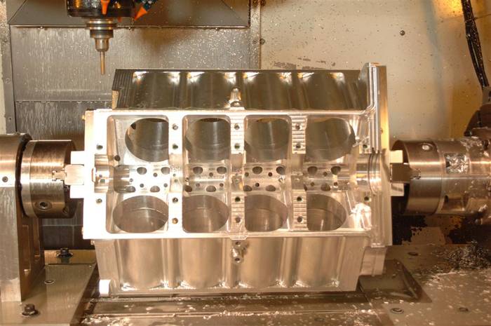

The mains are almost done.

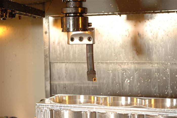

Getting ready to do the final pass on the cylinder bores with a boring head.

We had to do a little custom work on the boring bar to make it stick out past the boring head.

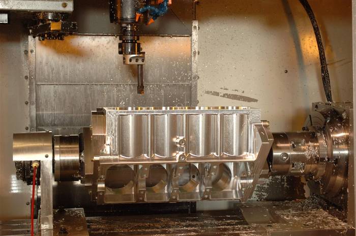

The bore is quite deep for the sleeve.
