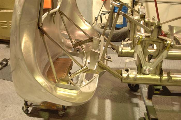

The nose tilts
  #32 (permalink)
Old 02-02-2011, 06:20 PM
David Kirkham's Avatar
Original Shelby Owner
Location: Provo, Ut
Posts: 6,990
Here is a peek at the hinge we made. I will be posting a Kirkham Motorsports University Flip Top 4 video soon.

Originally Posted by N2VENOM View Post
Congratulations... Taking an aluminum body and cutting it to pieces takes guts!
Should we start apologizing to the purists?
Hey fear is the thief of dreams. We couldn't see failure...we were to fixated on your dream. By the way, you don't need air struts. You can lift the nose with one finger...it's aluminum, not fiberglass.
The only problem...I think I want one now!
David
