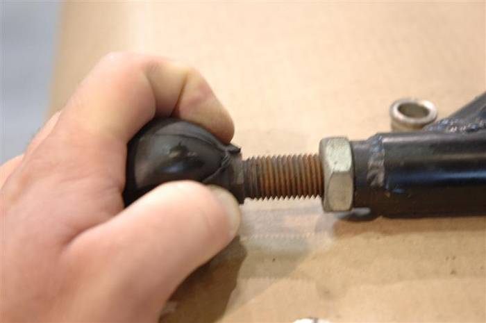

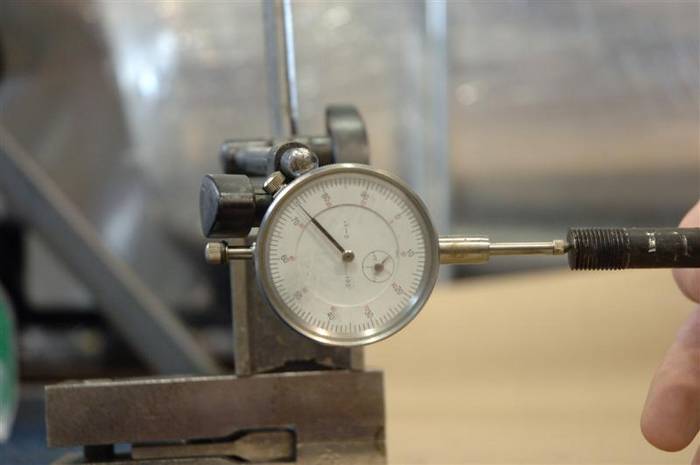

Notice how this one DOESN'T!!! The tie rod has moved 0.025" with our fingers. Just think how much it moves when you are really leaning on your machine. This car will NEVER align like this.
We also found the bushings were completely worn out that the rack slides on. From the looks of it, the rack was probably put together from various parts and pieces--and not too well at that. Cosmetically it looks perfect. Mechanically it would put you in the ditch.
Finally, notice how the threads are cut REALLY short on the end of the rack. Next comes a story that only would work on an original Cobra. Times were sure different then. Original Cobras ran an adapter on the end of the steering racks to lengthen the rack so it would reach to the wide track of a Cobra. (Well, wider than an MGB).
Original Street 427 cars had Sunburst wheels on them that were narrower than the normal Halibrand wheels. The steering arms ran into the Halibrand rims; so, they had to bend the steering arms inboard to clear the wider Halibrand rims when they swapped out the Sunbursts.
BUT, they still weren't long enough. They ALMOST made it, but not quite. (2 threads isn't enough to be safe with).
So, they ended up cutting the steering rack inner tie rods back 0.9 inches/side and then still having to put an adapter on to make up the distance.
Reminds me of High School shop class.
Anyway, here is the wiggly rack. Notice it has moved just over 0.025 inches.

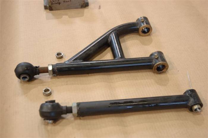

Now some commentary on the rear suspension.
This is a picture of the rear upper control arm and the trailing link. You can see the rear upper control arm has a cross tube welded on it (between the ends that attach to the frame). This is NOT original. The original street cars did not have this tube. The original S/C cars had a plate that was welded between the tubes (if I remember right). We welded tubes in the rear upper control arms of our early cars as well, but we welded them much closer to the pivot point of the control arm so they were more stable.
The trailing link is very interesting as well. There is only one rod end (heim joint as the English say) on the trailing link and the trailing link can only be put into the rear lower control arm ONE WAY!!! That means you have to rotate the original trailing links 360 degrees to adjust the toe! This is VERY BAD as you have very little fine adjustment of the rear toe. On our cars, we put a left hand threaded rod end in one end and a right hand threaded rod end in the other end for infinite adjustment. That way we could dial the toe in perfectly.

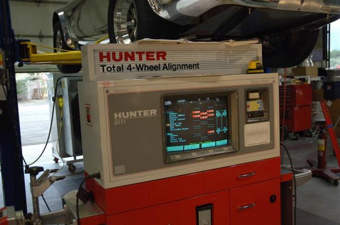

Now, for the most miserable job on a Cobra. (Well, there are more miserable jobs--like having to SELL your Cobra because of a divorce...)
ALIGNMENT ON AN ORIGINAL 427 STREET COBRA!
The only thing worse is alignment on an original 289 Cobra! (One day I will post that).
Notice we use a 4 wheel alignment system. That is because it is nice to have all 4 wheels going in the same direction! We asked the Hunter rep for the alignment specs for a Cobra!

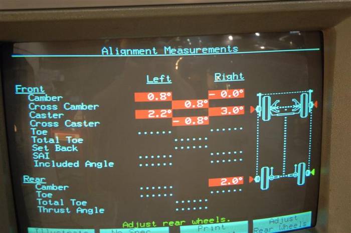

Here is a close up of the screen. LOTS of things you HAVE to pay attention to. When you change one thing, other things change! It is like riding on a merry go round. One of the particularly maddening things is tightening up the rod ends when you have everything "perfect." Just tightening up the rod ends changes the angles!!! So, you have to keep trying until it is PERFECT! When these cars are perfectly aligned...magic happens.
