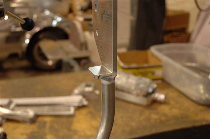

Here we are using wood blocks so we don't mar the tube as we give it a few tweaks. Some bends (called "bend on a bend" in the industry) can only be made with dedicated tooling as you have to have a certain amount of tube to grip on to so you can bend it. In such instances (only the tops of the doors in our case, so a $7,000 die is not justifiable) we do the time honored tube tweaking with blocks of wood.

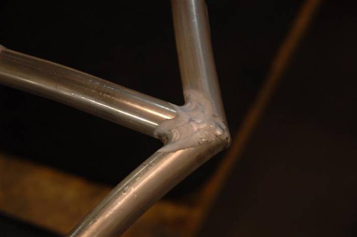

Nice fitting joints makes for nice welds. When the joints fit nicely, then the tubes don't warp as much in welding.

Here you can see we take a lot of pride in tight fitting joints. When the tube joints are tight, they don't move much in welding. Some pretty good welding too, if I say so myself. Of course, I have been welding for over 20 years now--but I don't do it much any more. I learned to weld at my first job in the mechanic shop at BYU. I was just 17. I hired on to sweep the floors--literally. My boss, the head welder there, told me I'd never learn to weld when ever I asked him if I could watch and learn.
