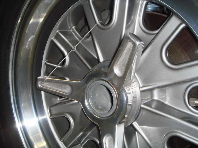

Originally Posted by A-Snake View Post
Ok, let's start with your comment "I have a loop in the safety wire that I monitor before each drive." I took that to mean you had a loop in the wire around midway and if the loop straightened out the knock-off had moved. The wire in the picture is shown more or less straight showing the knock-off has rotated counter-clockwise which would be "loosen" on right hand threads. What am I missing?
Now that I look at your safety wire a few more questions come to mind. The wire looks rusted. Are you not using stainless steel wire? How is the wire wrapped around the segment of the wheel? Did you drill a hole in the wheel as I don't see the wire going around a segment of the wheel.
http://www.whizwheels.com/Tips/safetywiring.html
Maybe its the perspective. Here's what it should look like (with stainless wire). Yes I drilled the wheel and wrapped it around the webbing. The loop is still there in my first pic. You're just looking at it from the side.

TButtrick
More of a concern once you do get the hubs & wheels installed in the correct
( accepted ) position, is the lack of thread grip you appear to have on the spinners.
On my Vintage hubs & wheels I have all of the starter portion of the hub plus several threads exposed once the spinners are installed.
Unless yours are designed differently ( I would like to see a photo of the hub, less wheel & spinner ) I am under the impression you do not have enough threads holding the spinners in place.
Craig

Posts: 1,330
Originally Posted by cdnus View Post
TButtrick
Craig
This is how they arrived from Vintage Wheels. All the threads on the spinner and hub are engaged. Making the hub longer will not make a difference.

Looking at your photos one can see clearly there is at least a portion of unthreaded area of the hub inside the spinner. On mine that is quite wide ( I will have to go out to the shop & measure to be exact ) if yours is the same you do not have enough thread holding the spinner on.
Craig
Went out & measured---3/4" protruding out of spinner.
1/2" unthreaded starter nipple--approx 2 threds=1/4" Total--3/4"
So if yours are manufactured the same, you do not have proper thread engagememt
Craig
Last edited by cdnus; 07-31-2008 at 08:47 AM.. Reason: verifying fittment of spinners.
Looking at your photos one can see clearly there is at least a portion of unthreaded area of the hub inside the spinner...
Craig
I think Craig might be right. Here's a shot of mine for a comparison.

Todd,
Do your wheels have recesses in the back for the lugs that hold the adapter on? If so you need to make sure the recesses are lined up with the lugs to allow the wheels to fully seat against the hub... this in essence makes "the snout longer" and you get the proper (read more) thread engagement.
If you need all this redone, stop in sometime. We do this on every car now.

Originally Posted by Cashburn View Post
Todd,
I had to clearance my "pin holes" on the wheel so it would seat all the way down. If that's the difference in Todd's snout measurement I'd think some major wobble action would be happening.

Originally Posted by TButtrick View Post
WOW! ...now where's my happy weed. Now, can you tell them its OK to drill the wheel for the safety wire?
You can drill the wheel (depending upon where you drill it) but we don't drill the wheel, we just wrap it around a spoke.
