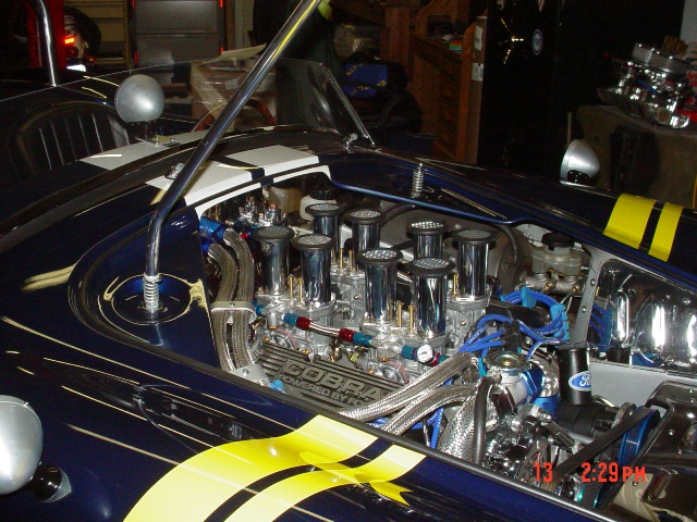

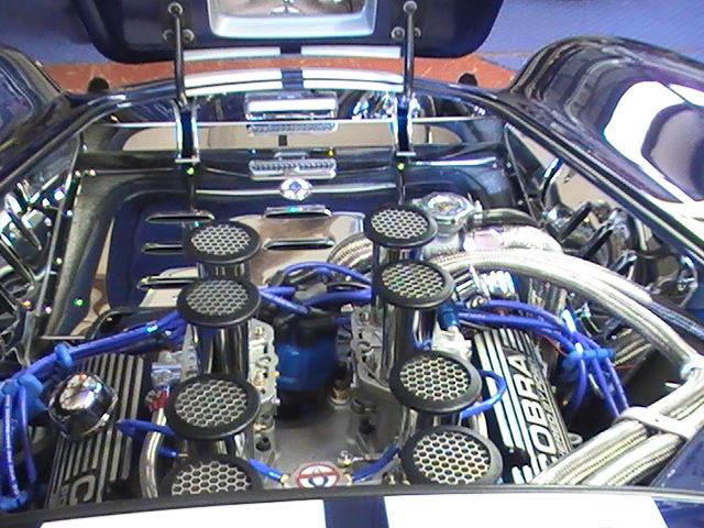

05-25-2009, 06:49 PM
Location: Graham, WA,
wa
Cobra Make, Engine: Everett-Morrison, 347 Stroker
Posts: 425
05-25-2009, 06:51 PM
wa
Posts: 425
05-25-2009, 07:02 PM
wa
Posts: 425
Before Weber's, Now seems kinda plain Jane don't ya think!
