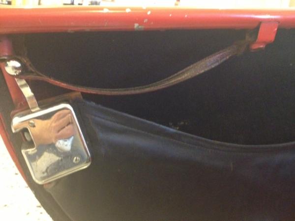

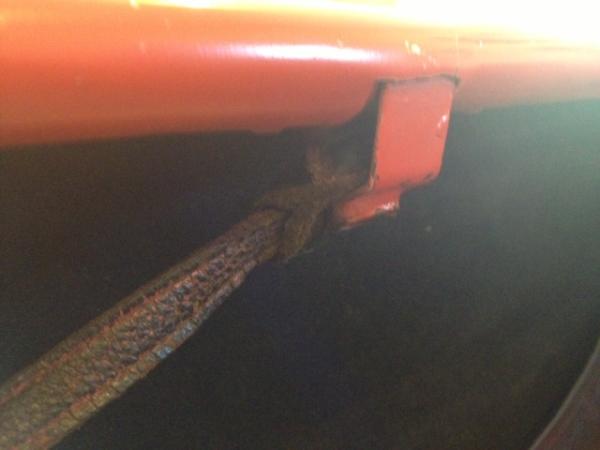

Here are some photos of the door pull strap on my unrestored 289 cobra. The strap has a sewn in loop at each end and is then is just looped through itself at the end loop around the side curtain ferrule. I have seen a couple of other unrestored 289 cobras that had the same/similar configuration, but I have not seen original shelby factory photos close up of this area.

Here are some photos of the door pull strap on my unrestored 289 cobra. The strap has sewn-in loops at both ends, and the strap is looped through itself at one of the loops around the side curtain ferrule. I have seen a couple of other unrestored 289 cobras that had a similar/same configuration, but I have not seen original shelby factory photos close up of this area.

Great shot of the 289 door thanks. 427 didn't have the gusset on the on the center ferrule tubes. It should be screw and trim washer like bonnet centering bumpers.
Good pic of the door here csxinfo.net - Photo Gallery
Hi Nick,
It is difficult to see on the picture you posted. Does the screw go into the underside of the door skin/frame? What are the "bonnet centering bumbers" that you referred to?
