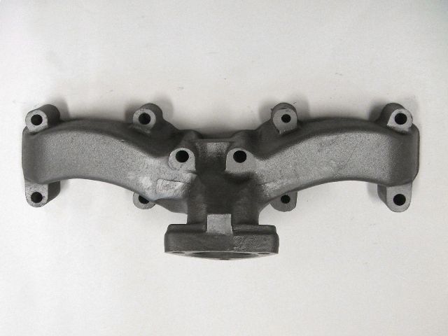

I wonder if something like this would work:
Centered outlet (might clear the footboxes), straight down outlet for under car exhaust.
Not great for horsepower I know.

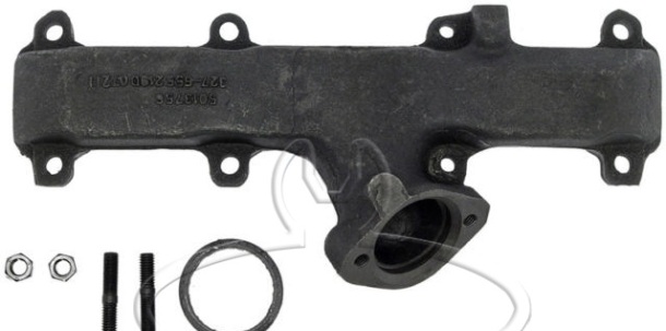

Something like this looks more like the original 427Cobra Street log style exhaust manifolds:
This is a LH, which swapped to the RH side would clear the pass footbox better.
Now if only I could find a RH to swap to the LH side.
Greg

The first one you show is good for centered outlet but not the log look.
The second one has the log look you're after but direction/angle on the exit.
