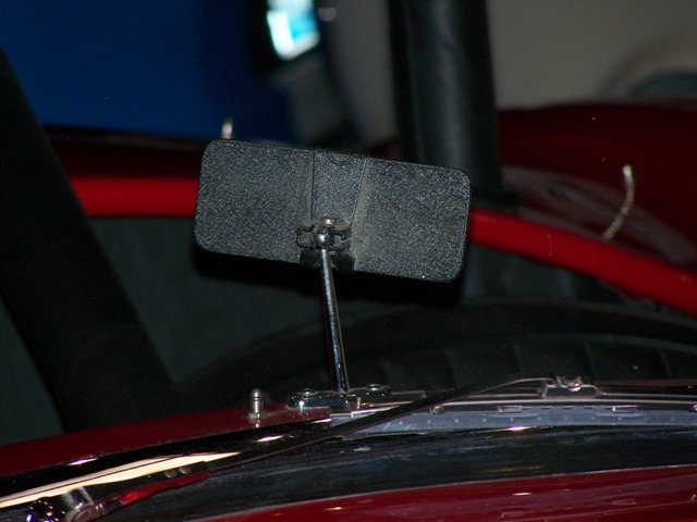

So in a previous thread we learned the dash mounted mirror on the street 427Cobra's were finished with a black wrinkle paint on the back of the mirror, the mirror glass surround trim and the bracket that holds the mirror to the stem. The upright stem remains chrome.
So what kind of black wrinkle paint to use.
I've tried the VHT Wrinkle paint but it's finish is a mild orange peel at best. And it's very glossy.
I remember using black wrinkle paint on my MG back in the 60's and it was very wrinkley to the touch almost rubbing off in flakes. And was a flat to satin finish.
So has anybody had recent experience with a flat/satin finish black paint that really wrinkles?

I reworked my rear view mirror to more accurately reflect an original several years ago. What worked for me was Krylon Wrinkle Finish paint. The directions said to apply two or three heavy coats. It worked great for me. Good luck with your project.

Here is a tip I wanted to pass on to you. I just painted some additional parts yesterday and after they were painted I put them in a 200 degree oven for about 20 minutes, it really enhanced the wrinkle finish. Hope this helps.

Thanks for the tips guys. A local restorer suggested two or three spray coats seperated by two of three minutes, let dry for ten to fifteen minutes and heat using a heat gun .
Worked well leaving a pronounced wrinkle finish.

Heat makes this paint work, along with heavy coats sprayed in 3 different directions.

FYI, that is a Lucas #104 mirror

Thanks Jeff. I was able to buy an old Austin Healey Bugeye Sprite mirror on e-bay that has the same mirror bracket/clip.
I'll send a pic of mine later.
