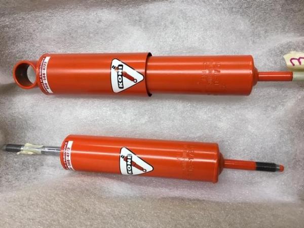

Found some better pics. Rear shocks have dust covers.

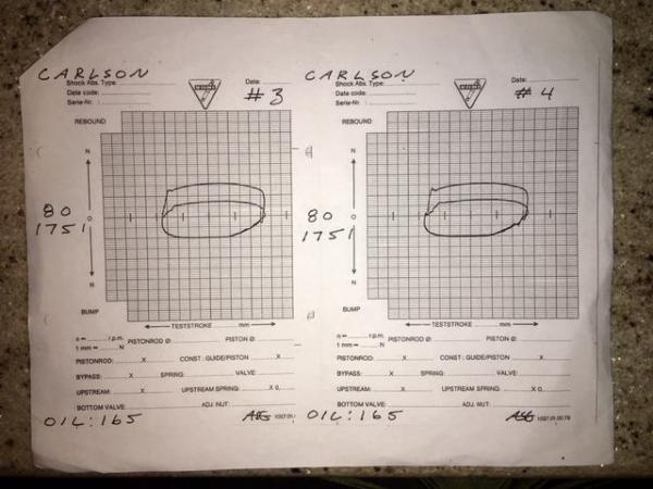

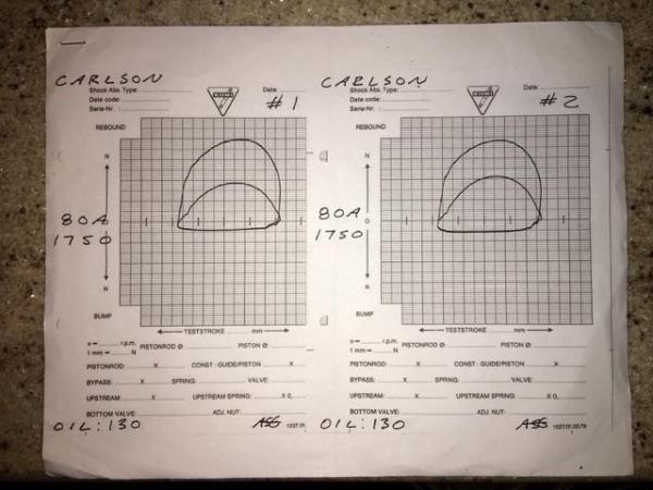

shock performance 1
05-14-2019, 12:46 PM
Join Date: Jan 2004
Posts: 69
shock performance 2
Charts are for the above Koni shocks on a 1967 1/2 Datsun Fairlady 2000. They wanted the overall and corner weights for the rebuild. Not Cobra related, but a possibility at the time. Interesting discussion to follow.

Hey ! Larry and others that had interest in this thread. I purchased this set of used Koni shocks several years ago. Was told they came off a leaf spring cobra. They are part number 82G-1359 They are embossed with the winged logo and are stamped 4 -70 also have the winged decal. Extended length is 14 3/8 from the center of the eye to the end of the stud. Shortest they can be are 11 inches. What do you guys think? Are they for a cobra? Also these were made 4 month of 1970 and still have the winged decal and are embossed the same way. Anyone have the Koni parts numbers.

Scaling a profile of the 289 front suspension, the damper has a static length (between mounting points) of 11.1". Add/subtract about 2" for jounce and rebound travel.
