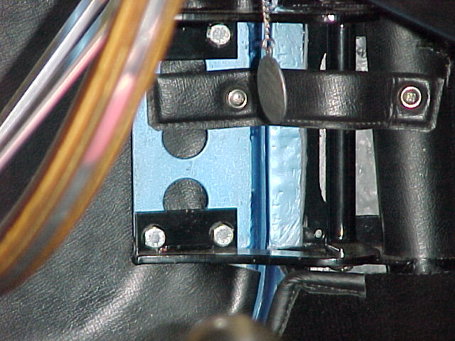

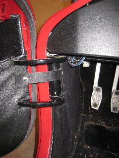

The Kirkham door hinge has a small "jag" in the metal that meets a travel-stop in the hinge, to avoid the door from being opened too far.
The original strap was a piece of black folded, padded leather...sewn on three sides, and attached to the door-side hinge plate on one end...and the lower cowl tube that surrounds the foot box on the other. It was held in place, I believe, by sheet-metal screws over trim washers.

Great picture, Ron - thanks. The computer works great by the way. My 17 year old daughter thanks you!

Here is what the strap looks like on my 289 replica. The door end of the strap is attached to a steel plate that mounts the hinge. The thick leather has not stretched in 8 years.
Thanks Ron and Jon. The pictures are what I was looking for. Does someone make these padded/sewn straps, or do we go to a shoe repair store and have the local cobbler make them up. Doesn't look too complicated.
