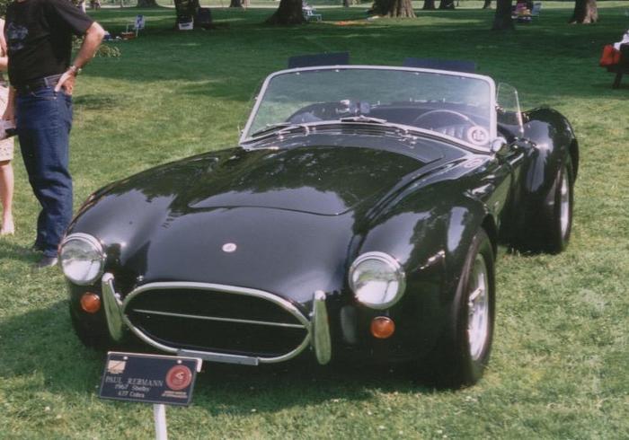

csx 3352 color code
This car is sweeeeeet!
Anyone know the color code for this particular green? Any and all help Greatly appreciated!!!
Thanks
JB

The stock 427 color was Ivy Green:
Ivy Green (Custom) R-M Code A-1738

Thank you for the quick reply!
Since I am going with Superformance.............they require PPG Global paints.........how close is Tunnel Green code 47102 and Forrest Moss Green code 47103 to Ivy Green a-1738?
Greens are really tricky. Any ideas???

Just give them 1965 Ford color code "R" (Ivy Green), they can then mix the correct color in any of the manufacturers paint systems.

Ivy Geen is PPG #43337. Hi Tech (Superformance) has actually changed over to Glasurit paint, but can mix via either the PPG code or the Glasurit code.
