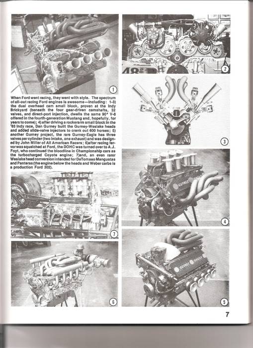

Hi Guys,
Here is an article from the Ford Racing days that outlines some of the engines referred to.
