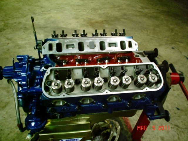

You can run a roller cam in any block.....even the oldest of old. Just run link bar lifters.
like this set-up in a 1970 block.......
