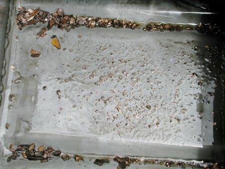

Got the pan off. I finally dropped the starter (as if it wasn't coming off anyway!). Then had room to get the putty knife further around the perimeter...did use the torch, seemed it did help.
Considered trying Jerry's idea of blowing it off but the fireworks stands won't be open for a few weeks and DARN, I'm out of dynamite...again.
Oh, on the pan, The plate bolted to the bottom that covers the trap door assembly...was NOT removed until now for the photo. But I DID remove the sheet metal dam (spot welded on) that ran from front to rear...sort of a "fence" to keep to keep oil from climbing the wall...maybe not accurate to call it a "scraper", more of a baffle.
Anyway, couldn't get the pan on with the "flow dam" in place over the girdle...do plan to replace the flow dam, and try to figure out how to retain the girdle.
In the picture the "bolted on bottom plate" IS off so you can see the junk.
FWIW the trap doors are free and easy to move, no binding.
In the picture of the lower end, maybe someone can tell if its a standard or high-volume by looking at the depth of the pump body...will pull it later on and check the parts number later. I ask as whichever it was, it was shimmed to lower the pressure when the engine was assembled. Initially over 100psi after shimming ended up about 80 cold. I do NOT want to do that in the car, the engine was on a test stand when that was done.
Judging by the amount of junk in the pan, very plausible, as someone suggested, stuff was sucked up against the pump screen and blocked it, dropping oil pressure further. When the engine was shut off, it fell back to the bottom of the pan. Man, you guys are good...
Until I clean up a bit and plan how to organize parts, caps, etc I am going to wait to pull the rod/main caps.
Seems pretty foregone at this point the engine is coming out.
Will post more photos when the caps come off.
Thanks, Pete

A couple of things,I had a similar girdle on my race engine and had to "beat" the built-in crank scraper back against the pan wall to clear the stud girdle (Canton pan), I doubt there is a pan out there that would fit with the crank scraper in place....on that note: had a nationally known engine builder told me the only thing the girdle will do is hold all the parts and pieces together when the engine blows up, and that's exactly what it did when I blew my engine....he advised that it was not neccesary unless one is using forced induction and 8000+ rpms...since I don't use forced induction and have a 7000 rpm rev limiter in the race engine, I did not use a girdle on the new engine...I rather have the crank scraper than the girdle.....
Next;that is a lot of "junk" in the pan, not good,it came from somewhere......
on the oil pump, the only way to tell if it is a high volume or not is the part/casting number..... I have both by Melling and they are identical from the outside, the difference is in the gears on the inside, that's all.......
I see you pan has the trap doors,same as mine,the only thing I could see if your motor starved for oil is a high volume pump and you were maybe low on oil in the first place??????? I've never expirenced low oil pressure or a drop in oil pressure in long sweeping turns with my set-up at all, with the pan you have,you should not either....My pan looks pretty much the same as yours inside and it holds 8 quarts....since it is the exact same depth as the stock pan, the stock dipstick works just fine, with my external oil filter and 12 AN lines and oil cooler, total capacity is 10.5 quarts....
I'm thinking something else caused your problem, ate up the bearings,debris clogged the oil pickup screen,causeing low oil pressure, then no oil pressure...
I don't think the oil pump nor the pan are the cause of the problem......just my opinion.....

the one pic looks like someone panning for gold!
the oil pump looks standard volume, can't tell for sure without a side shot.
i wouldn't even mess with it, start the pull process.
