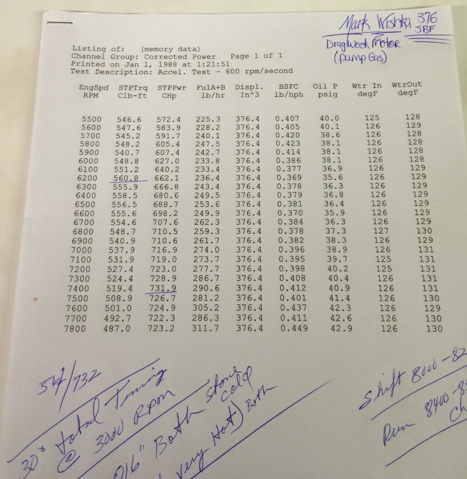

Here another engine Kuntz built recently. This 376 SBF engine was built for a weeks worth of abuse (drag week) Nothing exotic , 11.1 compression, pump gas, Jims 15 degree heads. It will run sealed all week (no vacuum Pump).

Impressive. Both engines have exceptional BSFC figures.
Can I ask what carburettors?
Gary

850 QF on the 438. not sure on the 376
