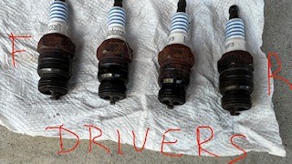

Default Old Plugs
Here are the old plugs that I removed.

Those plugs look awful. They're fowled pretty bad. I wouldn't declare rich or lean until I replaced them and started over. I can see why it might want some extra kick from starter fluid. Put in some new ones and see what happens.
Second, what is all the rust on the exposed part of the plugs? Was it stored in a very humid area?
renaissance man likes this.

@twobjshelbys
Tony, When I sold the car, 20 years ago it was in Iola, TX. about 3.5 hours east of where I am. Definately more humid. All of the chrome has bubbled on the bumpers and mirrors, a rat was building a nest in the DS pipe. When I started it, nesting material and corn flew out. Only 333.3 miles were put on her in 20 years!
Stored in E. Texas. Def. a lot of humidity! Since getting it back to the Austin area, oil is changed, coolant changed. Plugs that came out were gapped at .035. New plugs gapped at .044.

I'm going to assert the gunk on those plugs took a long time to build up. It's not new since you took it out of storage. So I'm not surprised it still runs bad. Start the debug tree.
