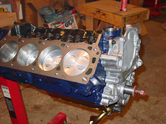

I took the freeze plug out of the timing chain cover (shown in picture) and moved it to the hole in the block. Then I could use the "fancy" Ford dipstick...
