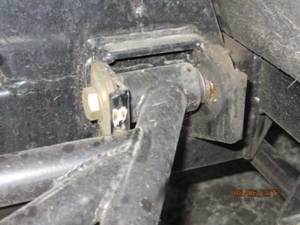

I checked all the calipers and brackets on both rear wheels. The only thing that looks like an issue is the lower control arm front mount is rubbing the body side bracket. The set up is adjusted by a large eccentric washer. As you rotate the washer it moves the bolt in or out for adjustment. If this is so, how do you adjust such an arrangement and know it is adjusted properly? I was going to get an alignment and seems like this might need one to adjust properly. I'll try and include a picture.
When you take a picture boy does it show the dirt~! I hope this is the issue because I don't want to pull any bearings.

The eccentric washer is part of what is adjusted when they set the alignment.
Once again I'm real sorry I forgot about this and left yesterday. It would have been real easy in Brian's garage to lift the rear wheels off the ground and check out the wheel bearings. But you can still do it at home by jacking the rear wheels off the ground and putting jack stands under the frame. Then start it up and slowly take it up to speed to see if you hear it. And when you are done, just push in the clutch and shut it off. Don't use the brakes. Let the rear wheels stop on there own.
John Hall

I don't think that is the issue, if it were it would not be releated to speed but road surface/bumps. Pull off the wheel and look for rub marks and see if any play in hub assembly

Randy Thomas of SCOF called and he walked me through several checks and I found my LEFT rear disk rotor lose. It is likely I have to replace the wheel bearing. The little rubbing in the picture I posted earlier is not an issue that I would hear driving down the road. So now I recall last summer hearing a tick-tick noise coming from the LEFT rear wheel. The sound I heard yesterday seemed to be coming from the RIGHT rear.
Randy explained a couple of other owners have experienced a similar issue. I am a SCOF member so I'll check there for procedures. I'll try to follow up and let everyone know what I end up finding.
