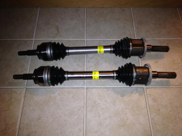

Changing out the existing T Bird 28 spline halfshafts to 30-04 Mustang Cobra halfshafts. These are brand new from Ford. I will reuse the existing 36 spline center bars. I'll post more here as I get free time. Carrier will be a TrueTrac and bushings will be solid aluminum (front and rear).

I considered using 4340 center bars, but has anyone broken the stock ones? The 4340 center bars are $460 from driveshaft shop.

Ford part number is 2R3Z4K138AA and cost is around $650 pair. Ford recently put these back into production. Generally good up to 550 RWHP on a much heavier Mustang.
