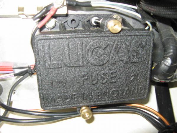

Really sharp! Was that fuse cover 3D printed?

Thanks for posting the pix, Larry. Much appreciated!
The fuse box was placed by SPF in the engine bay for accessibility, but was exposed to water splash, etc. It also looked, well.. pretty raw. Sooo, we whipped up a 'period' looking Lucas cover to fit it in SolidWorks, then printed some high resolution glass-filled nylon SLA models. We used Strasys, and they wound up really clean.
After painting them with black krinkle paint (standard issue Brit/Italian electrical part-'60-70s look), they looked just like an injection molded part. After making up simple standoffs to hold the cover, it was finished off with brass thumb nuts to complete the 'look'.
What do you guys think? Mission accomplished?

Very nice! We would like to offer these as an accessory! Is this the "surprise" that Ross is waiting for at my PO box?

I really appreciate you taking the time share your clever adaptation of the DB10 cover with us. I think it looks great and I am planning to give it go.
As far as the fuse box, you're correct I love it! Not so certain I can pull that one off though.... So, I hope you'll take Mark IV up on his offer but either way it's inspiring - many thanks!
Glad you like them! Yes, those are the items at your PO Box.
OK, OK, in the interest of advancing the popularity of these cars, I'll offer the Lucas fuse panel covers for sale. Until I get sued by Lucas
MK IV, I'd check your PO Box, and examine the 2 standoff assemblies that come with each cover, you will have to make those. They are easy to copy, and it will be more cost effective if you do them vs. paying me to do them. I'll supply the cover (painted) and with qty 2 brass thumb nuts and qty 2, threaded inserts for the fuse block.
I will supply a drawing to make the standoffs, and easy mount instructions for anyone else who would like a cover. They are very durable, and will accept engine bay heat easily without degrading.
The more orders I get, the cheaper the part will be for you all.
PM me over the next week, and at the end of it I'll email you worst case/best case pricing depending on orders taken. Regardless, they are very reasonable. It makes all the work to create them worth it, vs. making just a couple.

I just installed the fuse box cover that I got from Armrer and I couldn't be more pleased. It was complete, easy to install and looks terrific. It covers and protects the open, unsightly fuse box on my CSX8000. I think it would be identical on a Superformance slabside.

Ditto marklotus - I'm also thrilled with mine. Armrer's done a fantastic job with it. All components as wells as packaging were handled very professionally.

Sorry, just got back from travel. WOW, fuse boxes look great! You both did a great install : ) Thanks for sharing your cars on this thread
