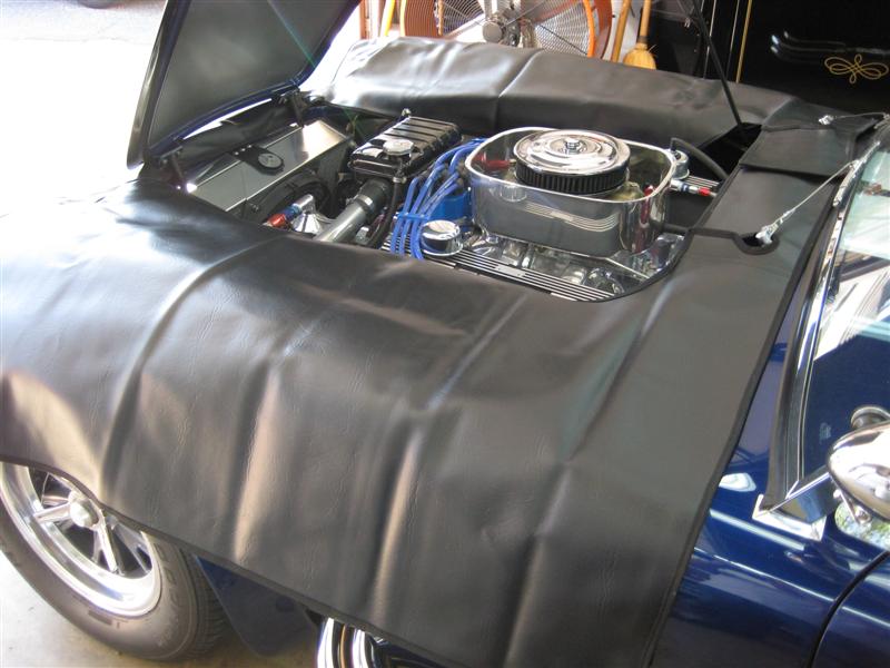

This is a handy thing to have. I think I got it from Finishline. Made to fit
