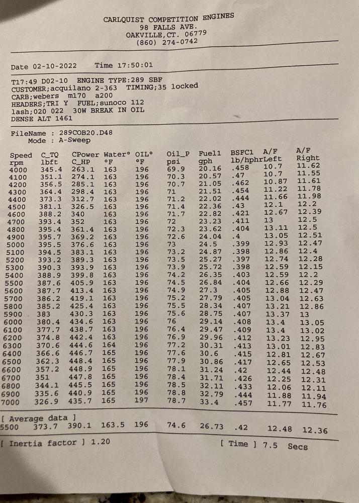

Dyno test and tune
I hope that everyone is ready for some good weather, driving and racing; I know that I am!
The last time at the track had some distributor problem and it turned out to be a bad MSD distributor gear. It need up ruining the cam as well. John Garuti from Cobra Automotive was there at the track and offered a lot of free help and guidance. We were going to try to switch out the distributor gear and finish the weekend, but once we saw that the cam gear was a little worn we decided to call it a weekend. John said that they no longer use MSD melonized distributor gears as the quality of them has gone down. He uses someone else for the gears.
Being that John spent a few hours trying to help, has done so several times at the track, and Cobra Automotive is only 5 hours away, I decided to have John do the repair. Drove out there on Thursday for the dyno tuning and to pick the engine up. They did a nice job of tuning the Weber's in. Everything is balanced and we were not far off on the jetting initially. I had 165's in and they were a little too lean, we jumped up to 175's and that was too rich, so we settled on 170's and they were just right. According to John and the person running the dyno it can take long days of work trying to find the right jet combination with the Webers. This was about the shortest session that they have had.
Here is the dyno sheet, I was pretty happy with these numbers for a little 289 with iron heads, and while John said that with some changes we could get over 550HP, that increased HP comes at a cost of decreased longevity. In addition, he said that they have found that cobra's with 500HP or more tend to behave poorly on the track.
Jim

Unless you have a right foot with a bit of talent, excessive HP will slow you down on a road course. There's a point of diminishing returns in relation to "usable" HP and corner speed / exit-off. The rest is simply drag racing.

Nice long flat torque curve, should be fun to drive !

Yes, I agree. You are faster making sure that you are driving a good line and not drag racing down the straights and then screwing up the corners. That's what John was alluding too, people were having trouble in the corners keeping the car straight. With the current setup I am running at 5 lbs/HP, that is all that I want, especially given a transverse leaf spring suspension with solid rotor Girlings.
What's funny is how we all have different perspectives on things. I was looking at the HP and torque numbers thinking about how they will help getting out of corners and moving faster down the straights. I shared the dyno sheet with my cousin, who helps crew for me sometimes and is involved with the enduros when I run them, and his first comment was, "Look at that fuel consumption, we are going to have to re-think how we run the enduros." I have a 15 gallon fuel cell and at 30 GPH during a 60 minute enduro, that creates a problem.  Looks like I will need to look at getting a 20 gallon fuel cell.

Nice!
Looks good, Jim! Gotta be happy with that! Are those chassis or engine dyno numbers? I am guessing it is at the crank. Bill at Carlquist did the first pass of porting on my 289 Hipo heads.
