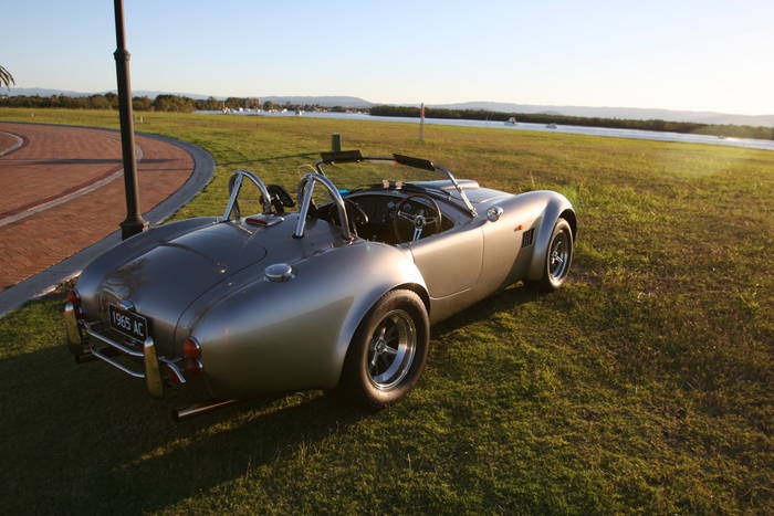

No Clearance Issues, but I am not using the standard exhaust. We installed a 2.5" system front to back, in the orginal style, but tucked it up more.
Regarding restriction. I am no expert, but my understanding is that you can get more performace (HP) out of an undercar system, than you can out of a sidepipes system - (now donning flame proof underwear) - But again, I am no expert and that's just what I have heard.
Also, having had sidepipes, and now undercar, I WAY prefer under car, for looks and comfort driving.
