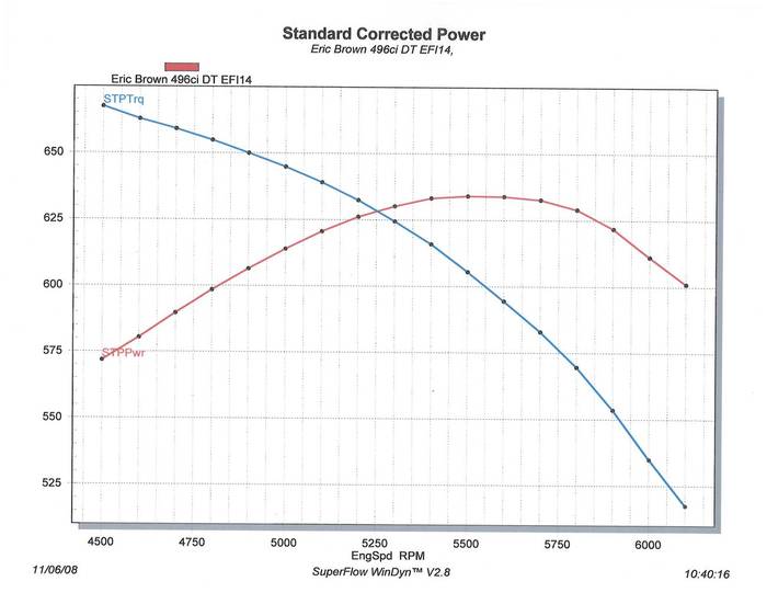

Well, I traveled to Arkadelphia Arkansas yesterday, spent the night, and left early to get to Hollywood AR to see my 496 FE get dyno’d at Keith Craft’s place. I was not disapointed! After a few pulls to get the timing and mixture adjusted, we tanked up with 105 and made a few pulls.
First, the walk around after warm-up
It should be noted that after warm-ups and a few pulls the DynaTek injectors were cool to the touch. Cooler than the room temp. It’s crazy.
One of the first runs
2nd best run
666 ft lbs, and 634 hp !!!!
YEEEEEEEEEE-HAAAAAAAAA!!!

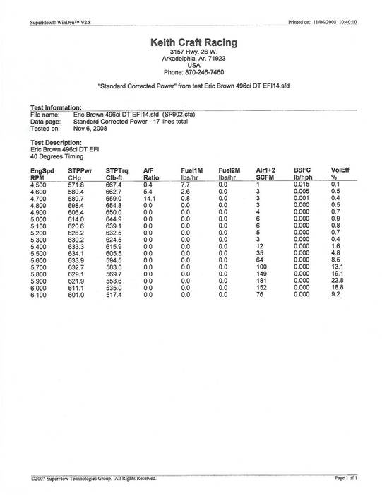

We had one other pull that was 667 tq, and 630 something hp. I’ll post the sheets tomorrow.
We put on the black booties, and dropped about 40/40, and the tune was then too rich. My guess is I will be going with the small K&N filters, or the tea strainer screens.
Hats off to everyone at KC, they really took care of me and my motor!
Now it makes the trip to Plano, I hope Michael and Gary are ready!
E

Terry, Thanks! Yeah I bet there are a few smiling faces at DynaTek. I believe this proves their claims of more hp and tq with their system. The distance that the air travels and location of the injector seems to be key.
Keith, Sorry I could not stay, but we had to get down the road. I would have to agree that the DynaTek system could take a bigger cam and make even bigger numbers, but as built this motor starts up with the flick of the switch, and will be very drivable! You and your crew really took care of me, and as you can hear got rather excited by the numbers that motor pulled!
Bill, this thing is a BEAST!!! RRRRRRRRAAAAAWWWWWWWWW!!!!! The vids do not do it justice, it is a monster after 4000 rpm and full throttle!
Mick, Thanks for the kind words. Did you feel the "FE Force" yesterday???
E

Peak HP at 5,500 RPM, WOW! Nice job KC and Eric.
