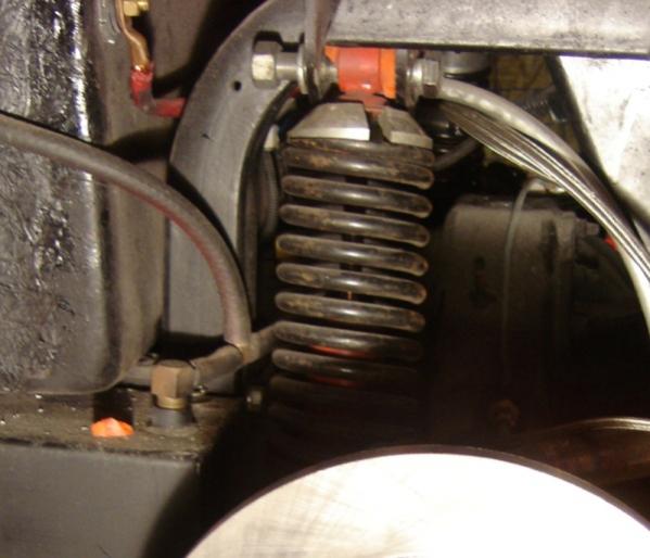

Posts: 59
here is a shot of the rear and fromt bushing.. The rear is pretty bad as you can see a piece of it is laying on the frame below it!

Posts: 808
Thats the top bush for the RR Coilover, doubt that is the culprit although it would give a similar action to a dud shock in your case. Check the links that run forward from the axle housing to chassis for similar problems or broken brackets etc, probably easier on a lift or over pit etc.

Posts: 1,137
It may just be the angle of the photo, but that top bolt looks like it's half way out. If so, that may also account for the broken top bush if it is moving and flexing.

Default Rear shock
That shock looks coil bound where the coils are close together not allowing the shock to travel in a downward direction. Just my 2c worth.

Posts: 2,703
the rear spring, as someone else had mentioned, has no travel, when it crushes the force is transferred to the frame, the frame then twists under torque and the car torque steers. let off the gas and torque is removed spring relaxes frame relaxes. springs are wrong at the least. the bushings are toast because they are first in line receiving all of the pressure.

Posts: 732
I agree with Rick and FWB having "pinned" it as rear coil spring bind and as FWB pointed out with no spring travel (if fully compressed at normal ride height) , the shock bushing is being hammered to a pulp. In any case it has to be in the rear suspension for such a drastic change in yaw under power.
I think your both right and this will be my first course of action that I take to fix this dangerous condition. Also "kitcarbp" I like your use of the term "yaw" as I am a pilot and that makes perfect sense to me. In aviation "yawing motions" can have dramatic affects on aircraft perfomace and handling so now you have given me my first clue as to the extent of what all this means. I'll let you guys know what the outcome is. By the way, how can I tell what the spring weight is? Is it stamped on the spring? Also by loosening the adjustable spring, is that only going to raise up the rear end?? The car already sits higher than I'd like. Are springs universal or do I need a spring to fit my coil? Let me know what to do first and I can take it from there I think.. Thanks fellas again for everything!!
