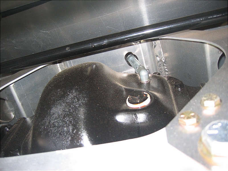

I can reach up over the top of the diffy housing and feel a small square drive ( pipe thread ) plug, but there is no breather installed. As an interim method I attached an adapter at the fill plug and ran a clear hose about 12 inches vertically with a temporary filter. I have looked at XJ6 illustrated parts info and they call out a breather......Nick, are the breathers you have seen coming off the small plug hole I described ????

Originally Posted by dcdoug
I think mine is the same as csx4017, but will look closer this weekend.
Meaning you ain't got one? Most vents I've seen look pretty much like what I've got on mine.

I wonder why? It can't cost more than a buck or two and the Jag people claim that if you don't have one, and run the differential hard, oil gets pushed past the seals. Routine Differential Service
12-07-2012, 03:01 PM
Posts: 22,017
You might just get this off of Ebay: Jaguar Daimler Diff Breather Elbow Tube Fits XJ XJS E Type 420 C25716 8509 | eBay

I believe I have indicated on an earlier thread that I wipe down the area around and aft of the diffy front seal after every run ( almost daily ). It has leaked from day one. The temporary vent tube I installed is not preventing the seal weepage but is relieving internal pressure . The Jag part will not fit on my diffy. The loss is so minor I am never in "lack of lube" danger.........Just another thing to do when your adjusting coil-overs. I think the 3 years between roller and driver didn't help. How long was the diffy sitting on the shelf prior to install ??..........Vent it Doug !

My diff never leaked, but I will vent it before putting it back in. Can someone tell me what all of these plugs are for and if the plug on the cover and the smaller plug on the top are both options for venting? Also, other than the main drain plug on the bottom of the diff, what's the smaller plug for?

Hey Doug the plugs are for plumbing hoses and fittings for the cooler. Look for the extra wires on the left of the diff for the pump and the bracket to the right of the diff for the pump. Scoop goes in the center ahead of the crossmember with the cooler. Let me know if you want help setting that up "while you're right there". I would vent it off the back cover but don't do it in line with rotating parts and install a good baffle on the inside or it shoots slung oil up the tube.

Nick is right on with the diffy cooler connections. Why not vent it off the small top plug hole ? The hose I have coming off the fill plug hole shows a slight discoloration for about 2 inches and then there are no signs that the oil has been pushed any higher. It works for now. Stupid part is that I have to disconnect it to check lube level.
