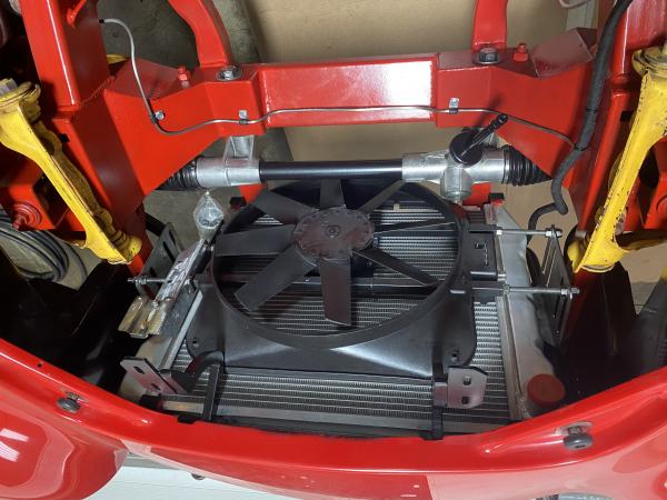

Hey Bulldog,
I was able to make this one fit with some modifications to the frame...
(19x24 and 3” thick)
https://www.amazon.ca/SOUTHWEST-SPEE.../dp/B00N06RNRY
Can’t figure out how to get the photos the right way up.

Sorry- just saw this. I can’t remember how many rows it is. You can shoot them an email- they’ll respond fairly quickly.
Oh- and when I said modifications to the frame, I meant radiator frame. Not the car frame. I had to cut the brackets at the top and bottom that hold on the radiator and weld in extensions as it’s much thicker than the stock one. You’ll also need larger isolators. It was a fair bit of finicky work to get it all together, but it’s much bigger than the stock one and solid aluminum.
I might have some pictures if you’re interested. Shoot me a dm(so I see it) if you’d like them.
