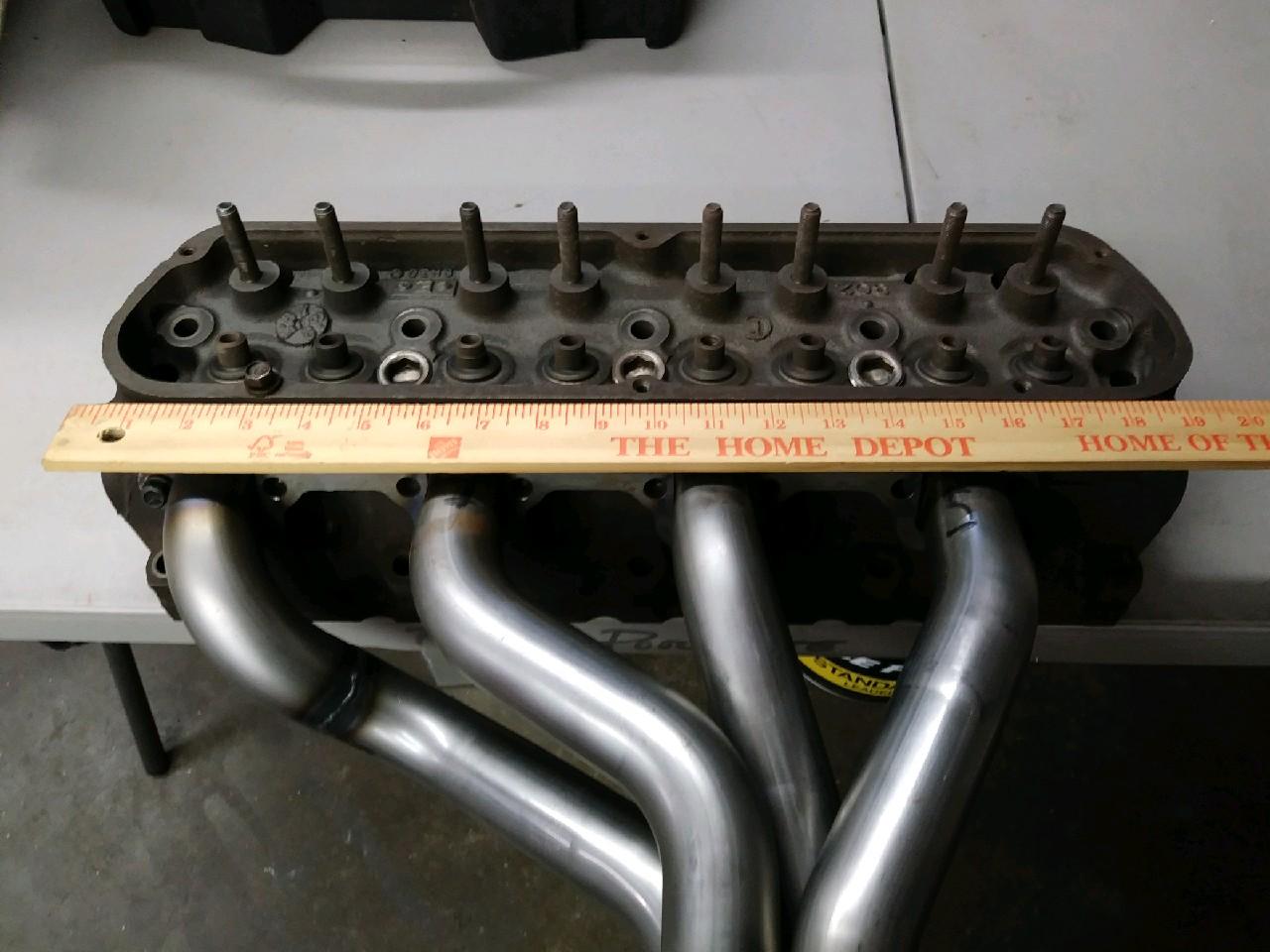

I am looking at a repro exhaust maniford that is a copy of the ones that go on the SBF Mustang, in lieu of the headers from ERA.
Was wondering if anyone had done this on their car, and if there were any issues getting them to fit in the engine bay.
Pics of each below. The Scott Drake hi po exhaust manifold on left, ERA headers on right.

Because the engine sits between (not in front of) the foot-boxes, it's doubtful whether those headers would fit. We'd love to find an aftermarket header that fits, but haven't been successful yet. It's especially difficult because the pipes must go out over the frame rails, not down and straight back.

Yeah when I saw the pics you sent me it's pretty clear they aren't even close in the way they turn out and downwards. A pity, but it just saved me $300.
